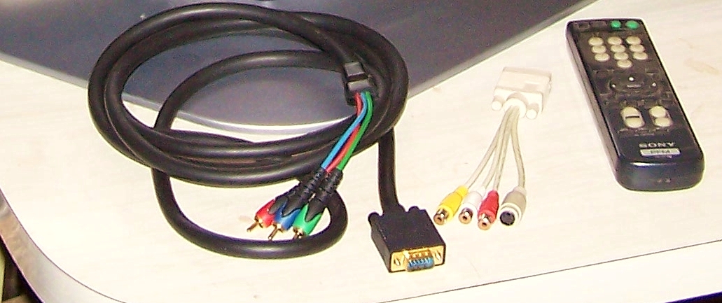

The reply i got was "you can only get a green picture, & if you fiddle the conections sometimes
its blue" yeah i said, sounds like the TUBE to me :twisted: & tongue in cheek told her i dabble
a little with computers & i'd give her $40 au for it if she did'nt want it, as it may have some
salvagable parts. To my surprise she accepted :freakout:
Note IN the pics the VGA adapter she was trying to use to feed an RGB ANALOG monitor a signal.

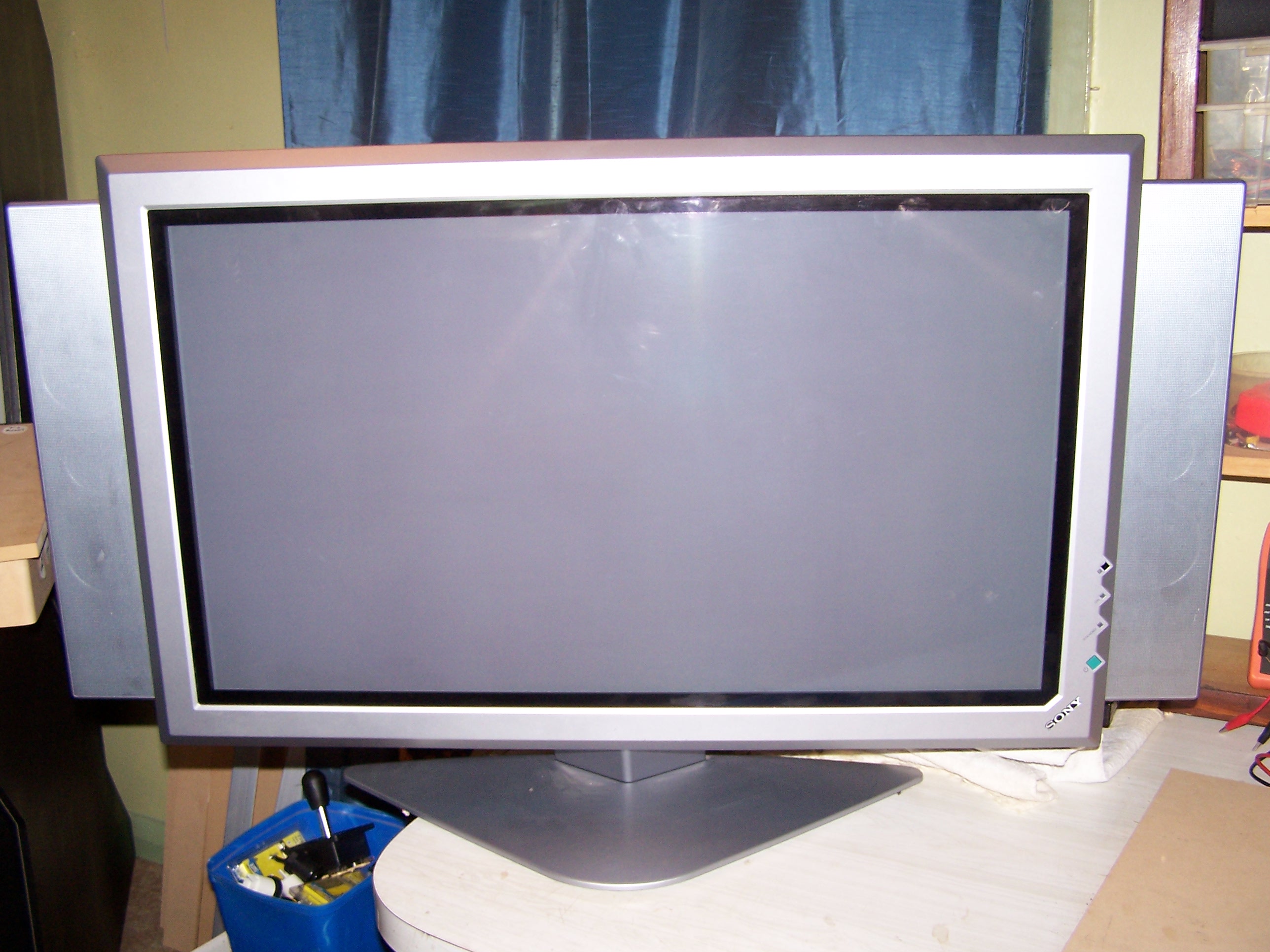

So what did i get for $40 :mrgreen:
SPECIFICATIONS - SONY pfm-32c1 PLASMA DISPLAY FLAT PANEL MONITOR
Picture Performance
Resolution: 1024 x 852 pixels
Pixel pitch: 0.84 x 0.39 mm
Active area (W/H): 715.68 x 399.36
Viewable picture area: 32-inch / 820 mm (diagonal)
Driver: 8-bit RGB
Colours: 16.8 million colours simultaneously
Type: AC-type Plasma Display Panel with anti-reflection screen
Sampling rate: 13.5 to 140 MHz

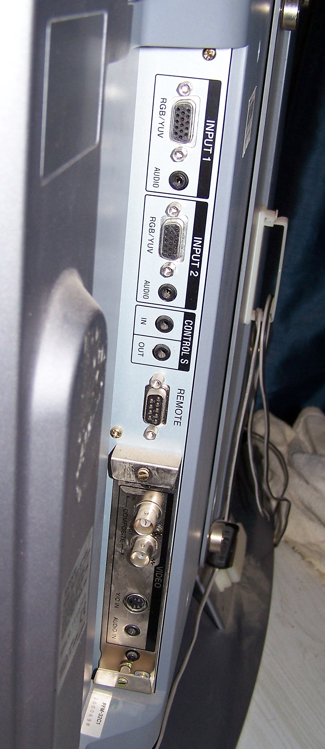

Input/Output
Input1 / Input2: D-sub 15-pin
RGB: 0.714 Vp-p/non-composite. 1.0 Vp-p/composite, 75 ohms
YUV: 0.7 Vp-p/non-composite (U/V). 1.0 Vp-p/composite (Y), 75 ohms
Audio: Stereo mini-jack, 500 mV rms, high impedance
COMPOSITE IN: BNC, 1.0 Vp-p ± 2 dB sync negative, 75 ohms automatic termination
Y/C IN: Mini DIN 4- pin
Y: 1.0 Vp-p ± 2 dB sync negative, 75 ohms
C: 0.286 Vp-p ± 2 dB sync negative (NTSC), 75 ohms 0.3 Vp-p ± 2 dB sync negative (PAL), 75 Z
AUDIO IN: Stereo mini jack, 500 mV rms, high impedance
COMPOSITE OUT: Loop-through BNC
Control S IN/OUT: Stereo mini jack, 5.0 Vp-p
REMOTE (RS-232C): D-sub 9-pin
SPEAKER OUT (L/R): 7 W + 7 W (impedance : 6 ohms)
the inputs
the monitor
