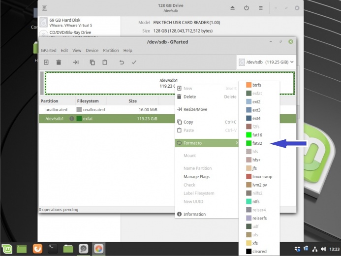

Now I’ve been experimenting on how to maybe bypass and to force my SDXC card to be formatted as 128GB FAT32, using guiformat.exe that was provided in the links from Raspberry Pi site for NOOBS. But the problem is that NOOBS needs to create partition for the Recovery and other partitions, and when I inserted my Micro SDXC card into my Raspberry Pi 3B+, the NOOBS failed to create the partition and couldn’t continue on. I then tried to reformat my card but only this time on my Linux Mint using Gparted as ext4 as well as FAT32; for good measures, and the same error occurred. So I’m guessing using NOOBS for the Pi wasn’t a wise choice except using Etcher to have the SDXC card formatted and installed as a Standalone Raspbian OS. I didn’t gave up just yet as I also tried PINN which is the unofficial enhanced version of NOOBS for the Pi. And well...sadly the results were pretty much the same. So this shows that the Raspberry Pi Foundation doesn’t appear to allow support nor paid for including the exFAT Filesystem data to be loaded in the BIOS boot system. And using Gparted for forcing the SDXC card to be formatted as FAT32 cannot give you the guaranteed results.

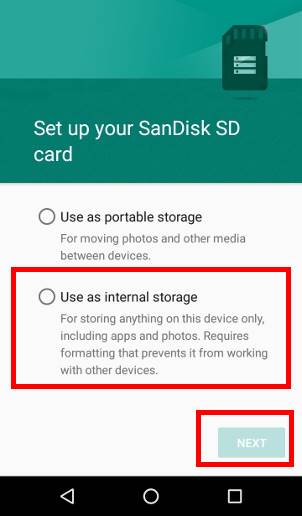

Whew…! So for Android SDXC cards well you maybe best off not using it. Because if you format it as either FAT32 or exFAT, then you will get a nasty shock as I’ve tried that for my Motorola Android phone as my phone requires me to reformat my card as either as Internal Storage or Portable Storage. But it became corrupt after a while as I’m guessing it created a partition with a exFAT partition when I had my 128GB card preformatted as FAT32. I don’t know if this will apply the same error for Samsung, LG, HTC even those OnePlus phones but nowadays most high-tier smartphones are becoming more expensive and it depends on which ones support exFAT cards – that can cause the selling prices to be higher. For iPhones and those discontinued Nokia Lumia Windows Phone 10s its kinda different. Personally I never had an iPhone in my life, but I do know they never support SD slots, USB or Flash Players. And of course Windows Phones had the advantage as Microsoft produced their own phones when they bought over Nokia’s Lumia series – that allowed exFAT and even NTFS support. But now Windows Phones 10 aren’t in active development anymore and will terminate any support by Xmas 2019. NTFS isn't widely supported for Linux but you can use ntfs-3g to allow support.
