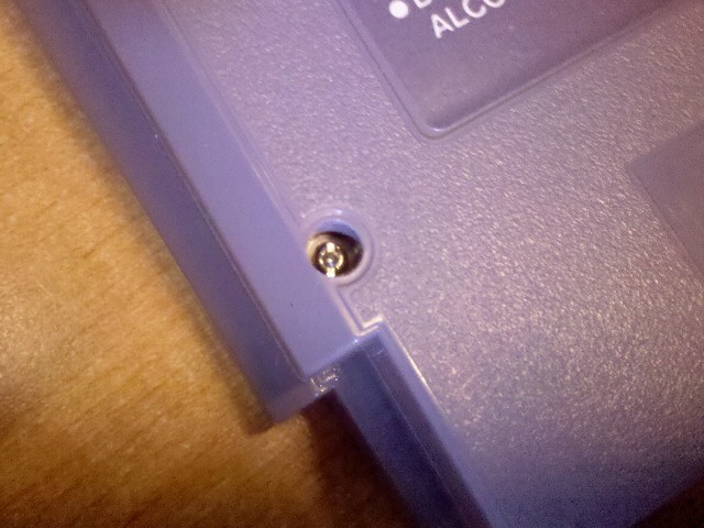

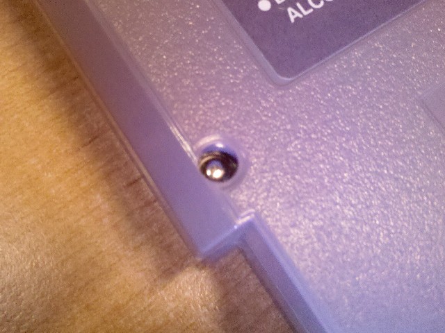

ok for the first photos, i will show you the two types of screws that you will see on nes carts.
remember, this mod can be done on ANY cartridge based games and other "card" based media.
[img]C:\Documents%20and%20Settings\Administrator\My%20Documents\screw_type1.jpg[/img]
notice that this screw has a circle in the middle and a slot that a flat head screwdriver can fit in to.

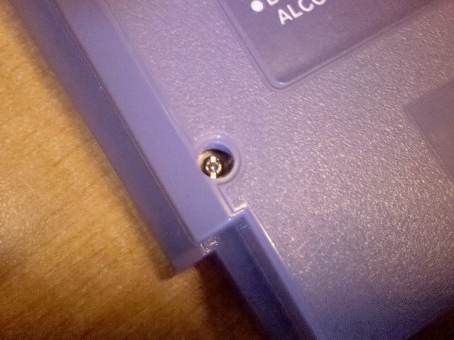

[img]C:\Documents%20and%20Settings\Administrator\My%20Documents\screw_type2.jpg[/img]
you will find that alot of nes cartridges have this type of screw. you may have to modify a screwdriver to fit this screw if you can't find a screwdriver online.

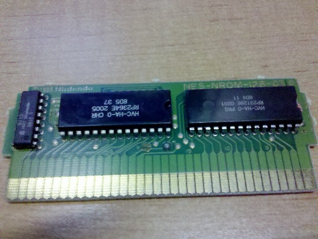

[img]C:\Documents%20and%20Settings\Administrator\My%20Documents\A_THING_OF_BEAUTY.jpg[/img]
if your planing on doing this mod on an nes cart, please note that there arn't a whole lot of places for a clamp (or whatever your gonna use) to hold on to the circuit board.

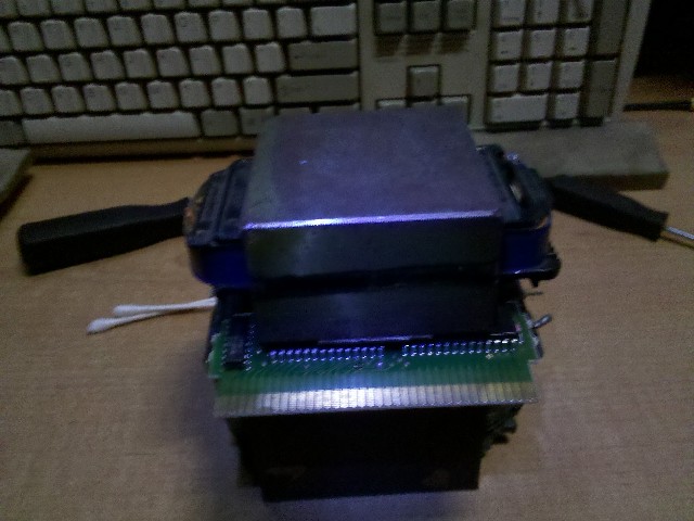

[img]C:\Documents%20and%20Settings\Administrator\My%20Documents\clamp.jpg[/img]
this is what i used to secure the circuit board. on the bottom is a transformer from a powerful late '80s
stereo system and on the top is a transformer from an apple imagewritter II printer. if you are only able to hold the board by the chips, please be very careful as to much pressure will damage the chips.

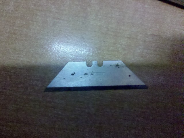

[img]C:\Documents%20and%20Settings\Administrator\My%20Documents\smoothing_tool.jpg[/img]
i found that useing a blade from a utility knife works best fore the job of smoothing the solder.

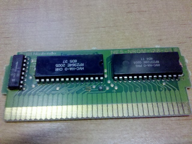

[img]C:\Documents%20and%20Settings\Administrator\My%20Documents\before_level.jpg[/img]
this is what the contact should look like after you aply the solder to it. remember to use as little as possible.

[img]C:\Documents%20and%20Settings\Administrator\My%20Documents\after_level.jpg[/img]
i wish i could have taken photos of the smoothing process but i couldn't do that and smooth at the sametime, sorry. now place the blade at either the top or the bottom of the row of contacts. it's ok for the blade to touch the other contacts because the contacts will set the final thickness of the solder. now place the soldering iron on the contact,making sure that it is touching the blade too. now as soon as all of the solder is soft move the blade and the iron across the contact,scraping the excess solder off of the contact.

screw type 1
screw type 2
basic NES cartridge curcuit board
(see if you can guess which game this is by useing the code on the chips :D )
my imporvised clamp
the smoothing tool i prefer
