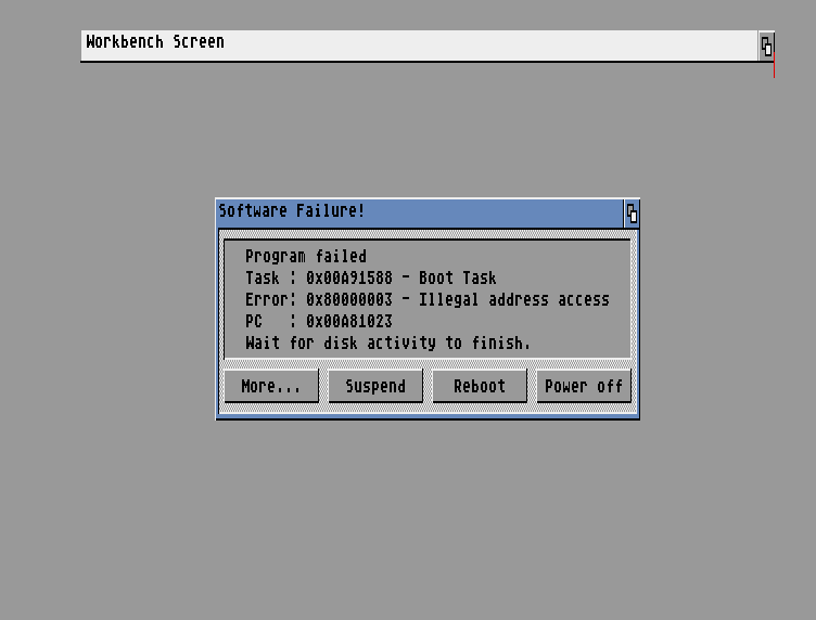

new to emulators (not to old commodores/consoles) doing ok using winuae most games will play but having issues with a couple ive just tried tonight.
ive got it set as a600hd with kickstart v2.05 rev 37 300 512k . chip 2mb , z2 fast 1mb , slow 1mb . everything else is as was on install and everything worked. tried dyna blaster and it loaded but screen jumped :shock: then donald ducks playground which wouldnt load? gave it a go using fs uae and it loaded but wouldnt difficulty select? tried a different rom and it gave an error window (ill try again and screen print)
as i said im new to it all and when i had my a600 25 years ago it was standard so mem upgrades are foreign to me . any help is appreciated thanks

Don't choose all the additional ram. The games on the A500/600 wont use it anyway (a few will). Choose 512KB + 512KB for a total of 1MB and leave the CPU as 68000. That should get you running.

It is always tempting to give your emulated Amiga lots of cool stuff, this is a mistake because lots of games were hard memory coded to specific address locations, which means they will crash any setup that is not physically correct. Few games made use of anything other than an A500 with 1MB and a single floppy.
